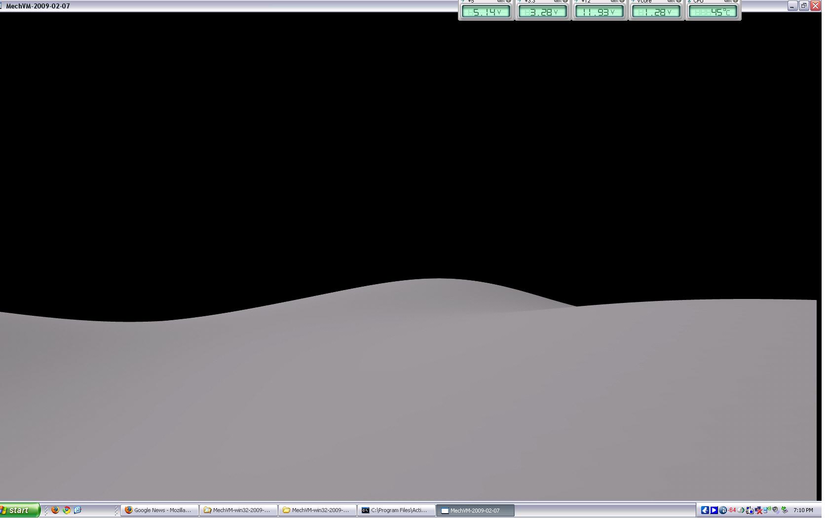

I got the mechvm to run, however it's definitely making things weirder. It says it installed then I go to play and I'm presented with a single white hill and black sky. Okaaaay....

Here is the MechVM screenshot. I installed normally, upgraded to 1.1, applied the Mech2XPv3 patch. Starts up fine until I go to play the mission. Opened MechVM, hit instant action and was presented with what you see. Not able to move and no sound. Weird. MWhook isn't working properly...not sure how to apply it. I had it create an icon just once, but I can't get that to happen again, therefore I don't think it's being applied. There is a small chance if I apply the mwhook correctly this time I may be in luck. Also there is this XVI32 Hex editor I have but I have no idea how to use it. The youtube instructions aren't that great.
OK, so it turns out, I can move around the environment in the below picture with AWSD keys. it's pretty small and the land just sort of drops off. You guys ever see this before?

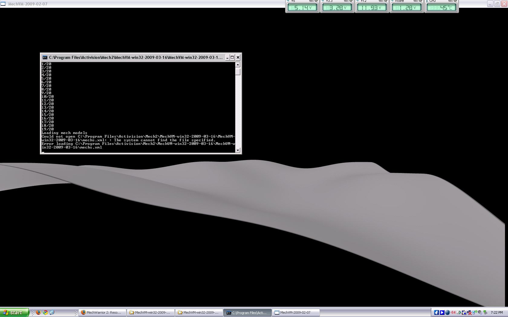

Also figured I'd show you what happens when I move beyond the edge, and the error report. I am missing an xml file?
Re: Titanium works fine...trying to get Pentium 95
heh, je2000 you mixed up mechvm's game with mech2. sorry about that
look for mech2 in the directory that it installed to. Do not launch through mechvm. It only installs it.
After it installs the game is already setup and ready to play. You should not need to make any changes further.
