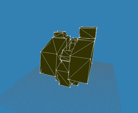

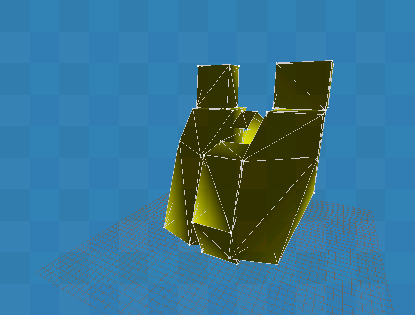

Skyfaller, thanks again for MechVM, this has made things a heck of a lot easier to edit.
I have edited a Hellbringer head on "3D Milkshape",
Yeah, it may look dumb, but it could mean a breakthrough if we can export OBJs back to WTB. Do you by any chance, Skyfaller, have or know if this can be done?
Thanks.
