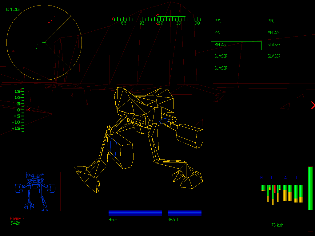

Skyfaller, I must confess, I was wrong; you CAN import WTBs from the other MW2 games, look at this pix below and tell me what you think this looks like:
Awesome head on Marauder Chassis.
At the time I did not realize that the PRJ would react badly when MechVM replaced a file with a new file larger than the original. But the problem is that most Mercs chassis and limbs are much larger in data size then 31cc, but the Awesome head was actualy smaller than the Marauder head, so that worked out just fine.
There are also some pretty cool shipshapes, buildings, and other mechs and stuff that are in the Merc's PRJ that could be used in 31cc, that opens a whole new field of mod options! :D

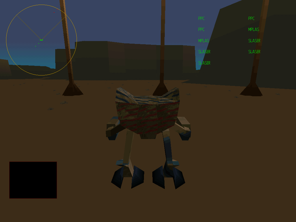

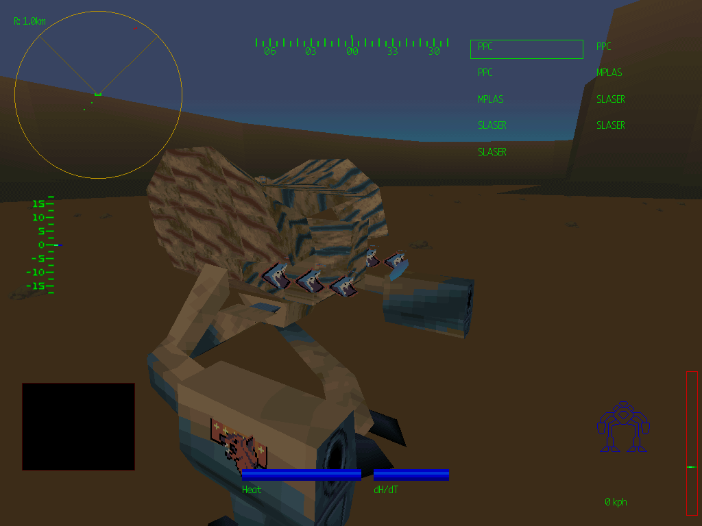

One question about the Awesome/Marauder hybrid: what does it look like in normal viewing mode? This might give clues about how texturing works. Do you see a normal camo texture? Please post a screenshot.
Re: Build-A-Mech
Here are those pix you requested Skyfaller:
I have no clue why the Diamond Shark logo is wrapped around where the guns should be.(???)

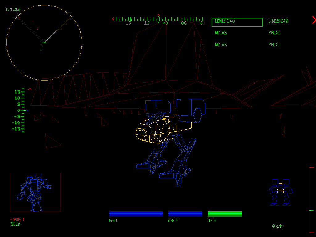

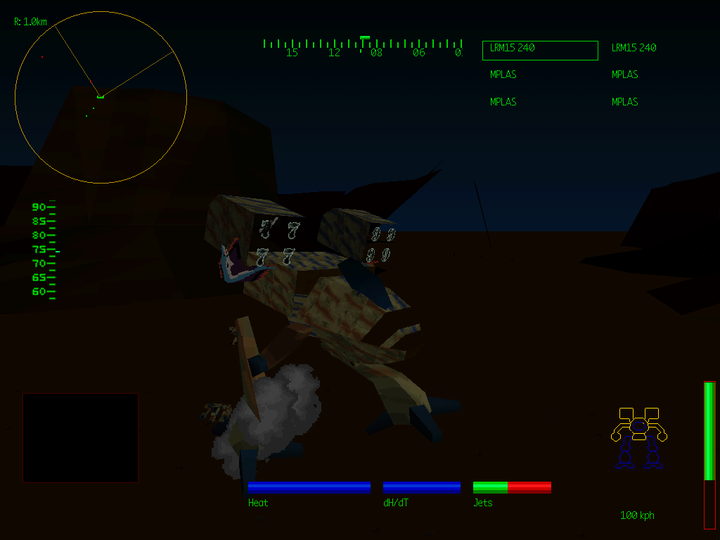

New mech
This is a Catapult on a Timberwolf chassis, I thought they would compliment each other real well.
Okay, Skyfaller, I have a theory about these odd textures. Could it be that the game does not select certain .XELs by name, but by the XELs location on the PRJ?
